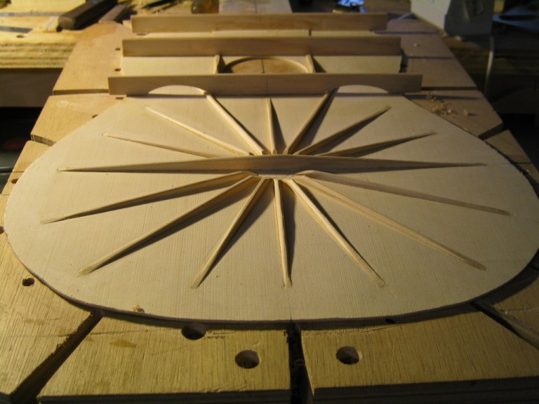

I developed an extended radial pattern, and borrowed an idea from Richard Schneider, which I incorporated into it. The heart of my bracing pattern is a cross brace directly under the saddle.
Note that the cross brace is asymmetrical -- it's a bit taller on the treble side. Bouchet did this same thing. As it turned out, this cross brace was way too big. I ended up shaving off about half its mass with a brace plane.

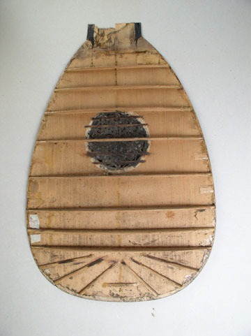

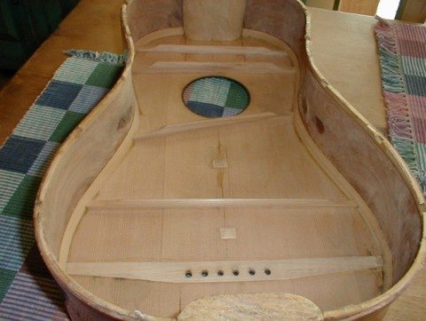

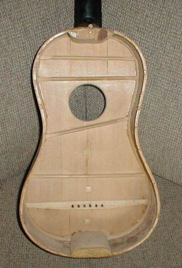

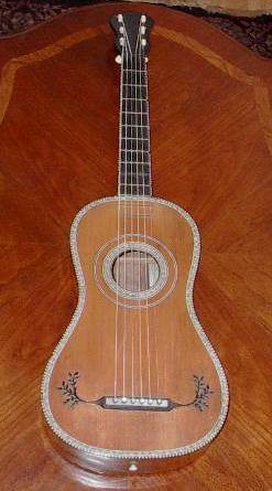

I think we dismiss ladder bracing too easily sometimes, especially for lightly strung guitars. One of the nicest sounds I have ever heard came out of a ladder braced guitar as well. Built by an unknown maker in about 1780 this little 648mm scale guitar had a gorgeous lively even sound. As you can see its pin bridged but the bridge plate has the profile of a full brace at its front and tapers off to the rear.
Mind you, I think the 220 year old Euro spruce top might hava had something to do with its sound. I intend to build a copy one day so maybe I'll find out. Note also the angle brace below the soundhole, sort of like a proto semi X-brace!
This 1764 Brunner has an early set of fan braces (thought to have come in about 1750). It's fairly heavy ladder bracing was because it had 24 strings.

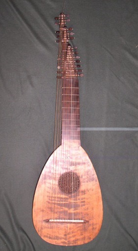

I think it is dangerous to say that a lute sounds like a lute because of one or two individual elements. It sounds like a lute because it is a lute! The same is of course true of the guitar, its all down to the small details coming together as a whole.
The early guitars I have played, mainly from the collection at the Royal College of Music here in London,(where I sometimes play, rather badly, in an early music consort), although certainly sounding like guitars, also have something of the lute sound to them, which I have always put down to the similar gut frets/strings and the rear bridge position, but I may be wrong.
There are pics of a couple of my lutes on the forum somewhere.
